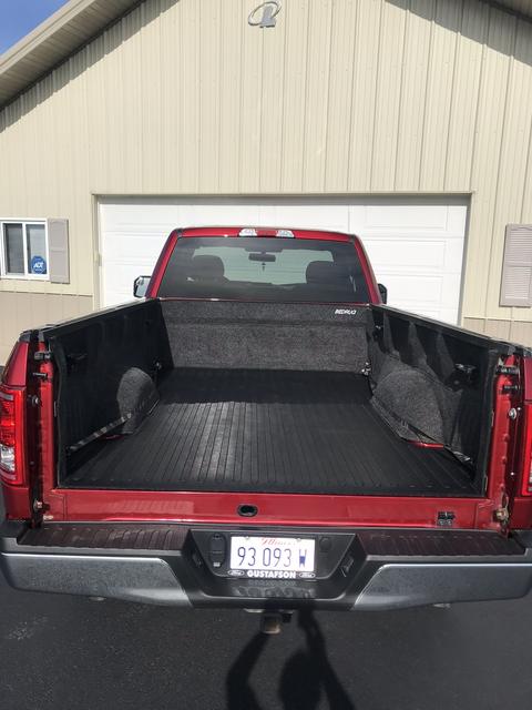

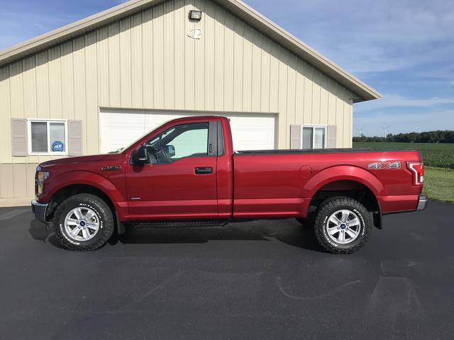

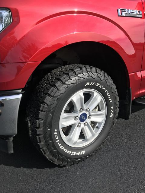

Finished my suspension updates on my 2017 standard cab. New BFG T/A KO2 rubber, Hellwig big wig air springs with out compressor. Other modifications Dee Zee rubber bed mat, bicycle air pump with custom behind the seat mount. Truck weight at a local grain storage facility 5000 with 36 gal of fuel without passengers. GVWR 7050, payload rated at 2155. Dry Camper 1400 estimated people and gear 525 yep it’s going to be close. As stated in my earlier post camper use 4-6 weeks per year. Mainly on flat Midwest terrain. Camper storage in our heated poll barn to protect this investment. Should have on the truck next week. I will post pics and truck performance numbers in the future.
