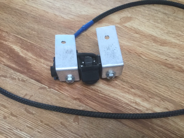

As a relatively new member, I wanted to share what I did remounting the backup camera on my Toyota Tacoma. I recently purchased a FWC Eagle and wanted to avoid having to remove the wring every time I removed the tailgate. This Tacoma has Aluminess bumpers installed which added their own mounting challenges.
After a fair amount of time looking at options and factoring in the fact that I wanted the camera to be able to survive some moderately aggressive off road-ing, I ended up making a bracket out of some aluminum I had in the shop. As most of you know, the OEM wiring harness is quite long which made the job pretty easy.
After determining the location, I mocked up a piece of aluminum angle. The hardest part was making the hole for the camera back tight enough so it would not wiggle loose. I used the two small screw that hold the camera to the original plastic base and drilled holes in the aluminum.
Some paint and a few stainless bolts, and this is what I ended up with.
The view to the rear is far better than the stock location and the camera is protected from below by the frame and hitch and from the back by the inward slope of the bumper. It would take a pretty specific hit to dislodge it. If anyone needs, I can take more pictures.

I kept my Tacoma camera relocation simple. I remove the wiring and camera from the tailgate, cut, bent and drilled a couple pieces of small aluminum stock and screwed it to the bottom of the center.
Maybe some day I'll get another camera and put it back in the tailgate. But it really isn't needed for such a small truck anyway IMO.

dasadab I have a 2015 2500 GMC for over a year I wondered what I should do to get a back-up camera working as it did when I had my tailgate on. Finally I took apart my tailgate to remove the camera and see if there was a way to mount it on the back of the camper. After doing it I don't know what took me so long.
The first thing I noticed after I removed the camera was the part number in huge letters 22803702. If you google GM part 22803702 you will find that the part is about $100 after shipping around $130. If you go to http://www.gmpartsdirect.com/oe-gm/22803702
there is a line near the top "Make sure this part fits your car" you can check to see if this part also will fit your truck. GM uses this camera in a lot of different cars I expect it is the right one for your truck. I just bent a couple of pieces of aluminum that I had on my work bench drilled a couple of holes and screwed it onto the base of the camper where it sticks out beyond the bed of the truck. I did buy a new one and mounted it back into the tailgate.
The advantage to buying the camera that you posted a link to is that when removing the camper or the tailgate you would not have to slide under the truck to plug or unplug the camera. The plug on the truck is on the drivers side between the spare and the bumper. I have found that I need to drop the spare down a bit to fish the wire over to where the plug is. The plug on the camera you are exploring looks to be the same as on mine.
